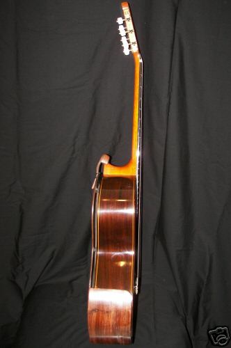

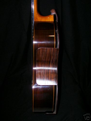

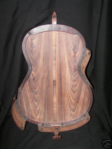

Manuel Contreras I built what he called a "Double Tapa" which was a second back suspended just above the bracing on the back of the guitar to improve projection.
He also built a doubled back shell which was intended to isolate the primary back and body of the guitar from the player. It clipped onto the body of the guitar at the heel and bottom by means of a friction fit. They are rare items now and probably in the hands of collectors. Here are a few photos of one that I saved for reference:

Here is a larger picture of the 3rd image of the Manuel Contreras back piece:
It appears that he used some cork or felt pads to isolate it from the body of the guitar.
